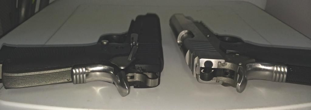

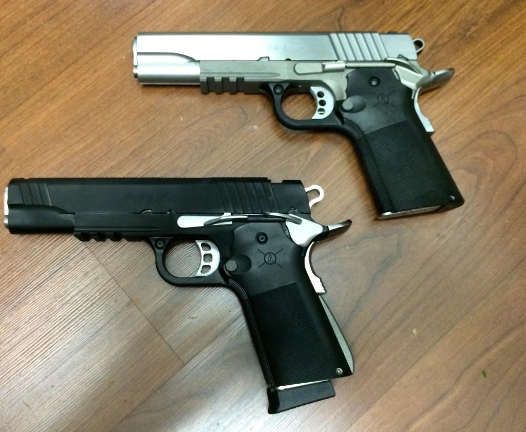

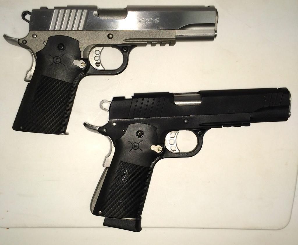

                    Just to add to the mix - just put these two together tonight after cerakoting them this morning.
                    Hopefully they just go bang, and not bang, bang, bang, bang, bang. . .
