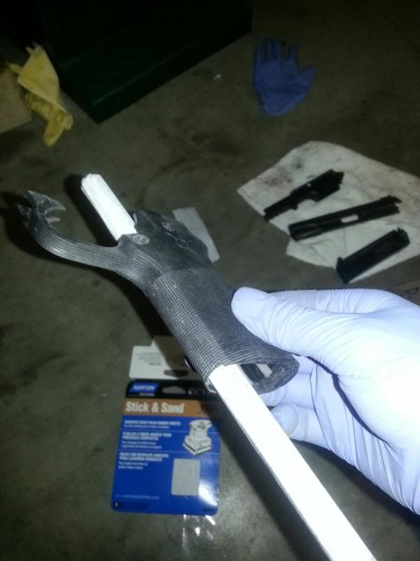

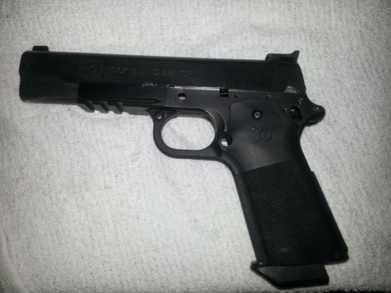

                            I just finished lapping the frame and slide. Smooooooooth. My hands are blistered but I put in my barrel and recoil spring to test out racking the thing... I've very impressed.
                            I used some 150grain sticky back sand paper with a 1/2" metal bar to san the magwell for it to fit. The cheap mag i had dropped freely after a few mins of sanding however when I put the grip on the frame it sticks hard. I have to take a look at it tomorrow when i'm not so tired with it on.
                            My slide stop doesn't fit for some reason so I'll check that tomorrow too and probably just buy a new one tomorrow.
